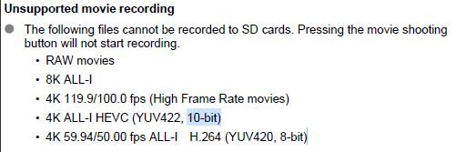

The R5 manual has 2600Mbps for 8k/30 DCI raw so about the same as 5.5k/60 raw. Hopefully Cinema raw lite/lower bit rates will also come in a future 1DXiii firmware update. Not needed for internal storage speed but to reduce storage space. It should allow external recording of 5.5k/60 raw as well
It only mentions 8 or 10 bit in relation to SD card performance. Raw should be 10 bit in theory.
UHS-II SD cards are rated to 300MB/s but in practice only about 8 cards are above 200MB/s sustained write speed.
