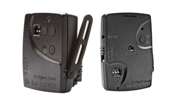

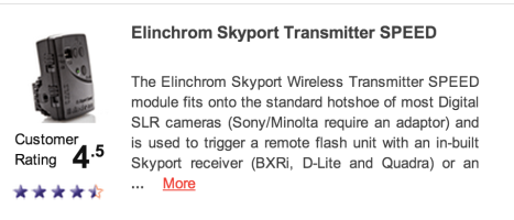

thanks for your advice you mean to say i should replace my previous recievers to the attached image els transcievers??and if i do will the fit in the flash head straight?do i need a seprate wire with that.one last quest the attached transmitter (my exsisting transmitter will it work/.?)can i reuest you to guide me step by step as i am entirely new in the world of lighting equipment.many thanks

Your transmitter is the same as mine. I own 3 of those. It works with my RX, Quadras, and BxRi units.
The receiver that I referred to plugs directly into the RX unit port on the back of the strobe. No wires. As noted they are made for the RX units.
