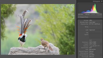

I, respectfully, disagree. Your statement about f/7.1 is widely exaggerated. I went back and took a look at some bird shots taken at f/7.1 ISO320. The shutter was 1/1600, but I could have easily raised it to 1/2000 or 1/2500 while keeping ISO at 1600 or lower. I also found some D5 BIF shots taken at f/8, ISO800 and 1/2500 These shots were taken in morning sun, so definitely good light and plenty bright. If taken at twilight or later, yes I would have had to raise the ISO, but for anything but early, early morning, twilight, or extreme overcast, f/7.1-f/10 are fine.
D5, f/7.1 speed 1/1600s at morning, around 8 or 9, can't remember accurately.(for wild life that's a "good light condition", normally I do not walk around in the noon so does most of the animals)...chose f/7.1 to keep both birds in focus, Manual mode, ISO automatically boost to 6400.
For online post or web use that's fine, but I do wish I could stay NO higher than ISO 3200, mainly because of the COLOR not the noise.
For M+Auto ISO, I use from EOS 1V, 5d Mark II, Mark IV...those combinations are different from flagship such as D5. That's my personal experience, but possibly I didn't study the user manual carefully, therefore I maybe use them "differently"
