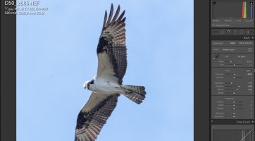

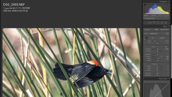

I didn't realize it was so easy to post files. These four were taken between 8:30 and 10am. The osprey shots were taken at f/8, 1/2000s and iso 800 and 2500. The lack of acuity is due to severe cropping rather than inadequate light. The other two shots were taken at f/7.1, 1/1600s, iso 800.
I'm not a big fan of auto ISO especially with cameras that are essentially ISO invariant above ISO 400 or 640. Thus, unless I totally blow the shot, it is easily correct in post. My experience with auto ISO is that it tends to raise the ISO too much. Of course, I could cap auto ISO at 1/3200, but I'm satisfied with my workflow.
Again, I have no problem keeping my shots (much) below ISO 3200 even at f/7.1 and f/8.0. I have a good idea what ISO is appropriate for light conditions, so I rarely have to raise exposure more than 1 stop in post.
I too use manual for iso invariant regions, especially for birds in flight, erring on the side of under-exposure. It's especially important when the background lighting changes as the bird flies across it. It's easy to guess the exposure from experience or using the sunny 16 rule, and pushing through a couple of stops is the same as upping the iso by a couple.
