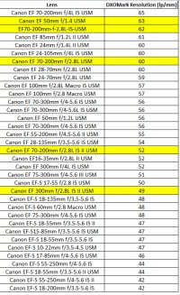

And then the lens scores.
Do they reflect the real feeling when we use the lenses our self ??
For the dab of stuff I've bought the *plots* definitely do. I don't bother with the silly "DxOMark" numbers though...
Well for me this list is not the way my lenses deliver in real world.
Would you buy your lens from this list ?
Then you would buy the 70-200 2.8 IS version over the version II !!!!!!!
Look at the 300mm F2.8 version II
I am lost in this lens score.

altenae said:
skitron said:

altenae said:
skitron said:
OK I am completely lost on how they score the lenses, because according to their score the Canon 300mm f/2.8L II USM is worse resolution wise than the Canon EF 75-300mm f/4-5.6 IS USM or the Canon EF 300mm f/4L IS USM ... Can anyone having both confirm that ??? ::)
I think the main thing with their method for scoring that gives counterintuitive results is that they appear to take the best result across the whole aperture range. They also do some averaging across focal lengths (the 75-300 doesn't peak at the long end). Also, they tend to allow for some degradation across the frame so a lens that is very good in the center with bad corners might get off lightly.
I'll describe the field maps in a bit more depth, I think this will be consistent with what users of these lenses observe.
You see that the 300mm f/2.8 is better wide open than the 300mm f/4. If you stop the 300mm f/2.8 down, it's not even close -- the 300mm f/2.8 is already near its peak by f/4. The 300mm needs to be stopped down to f/8 to be in the same territory.
According to the field map, the 75-300mm at 300mm is pretty horrid across the aperture range though if you stop down to f/11, the middle of the frame isn't too bad. At 100mm or less, corners sharpen up by f/8 and the center is sharp. At 135mm it needs to be stopped down to f/11 and longer than that the corners are bad.
elflord said:
Well what I mean is only the linepair value as they tested it on the 5d MK II. In this regard they tested the 300 f2.8 II as the worst !!! This is in complete opposition of every other test you find on the internet and I am sure that no one would spend about 8000 US$ for this lens if the other 300mm options would even come close ...
You can see what I mean looking at these side by side test charts:
The First one is the 300 f2.8 II at f4 against the 70-300mm f4 - 5.6 IS at f8 and 300mm. You see that these lenses look like they are not even from same the same planet resolution wise (as expected)
The second one shows the both 70-200mm f2.8 IS versions (I and II) against each other and the newer lens again is much better (also as expected)
Well, please take the time to read my comment which explains why the numbers are the way they are. There is clearly an issue with the way they aggregate the numbers (across the aperture and focal length range) but from the measurements themselves the 300mm f/2.8 has some clear advantages.
I think posters here are fishing for examples of cases where Dxomark's aggregation method is misleading (e.g. this sudden affinity for medium format is a bit hilarious) but they do make their measurements available.
In this case (the D800 or a number of other cameras), it's pretty clear where Canon is falling short on the test - dynamic range at low ISO.
