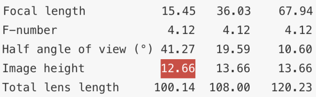

    Just to frustrate you, they're not just doing it for FF lenses. For example, the recent patent for an RF-S 15-70/4:
  8. Here's an example. The image heights for these 'RF-S' lenses are in the 18-20mm range, they're clearly for FF with intended distortion correction (with more of it needed the wider the AoV). The 'RF-S 24/1.8' lens mentioned in the post is actually the real RF 24/1.8 STM lens that launched a month before the blog post.
    Here's another, in this case the one 'RF-S' lenses exemplified in the patent is actually the real RF 16/2.8 STM lens that had already been on the market for several months.
    Oh i see.
    yeah wasn't me ;)
    Reading through translated patent applications is horrid stuff, especially when you are reading 20+ in one go, things can get missed like that.
    With a 18mm to 20mm image circle that's certainly not APS-C. interesting designs, but I hate them personally.
    and yes, Canon loves to troll me by stretching wide angles for APS-C and full frame in patent applications
    But then again. m43's have made that into an art form, so i guess we should blame them for starting it all.
