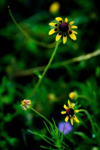

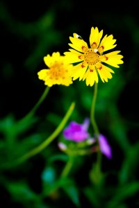

privatebydesign said:OK, this is easy to cheat, so don't. Which of these images were shot with the 135 and which with the 100 IS L Macro? There are no prizes and each will have their own tastes, that is not the point, my point is can anybody reliably tell the two lenses apart, if you are honest I expect few, actually nobody, can.

Now here is my input. Which of these were shot with a macro and the 135L?
So far you have committed to two images from eight, I wonder if you got any right from eight, I'll tell you which of my post were which in a couple of days, Plamen will have to tell us his.
Why would you find my lack of images impressive? That is such a strange thing to say, through this entire thread I have tried to get you to post images that display that "unique look" only the 135 can give you, do you think the "compression" of my 100 is different to others? That my lenses dof is better? I have also already pointed out that I don't have the 135 in EF, only FD. You are the one who has kept saying "only the 135 can do that", "35% more compression", "twice as much light", well, show me, because so far you have failed.
As for your four images, judging by the horrible bokeh I would say images one and four are with the 135, images two and three with the 100, assuming it isn't a trick question.

So which of the four I posted are the 135? You already said not the girl on the swing, so three more guesses. What difference would it make if I have used either, I am asking you to post an image that has the "unique look" of the 135, you know, the images with "35% more compression", "twice the light", "much narrower depth of field", I, and others, have posted images shot with both and you can't tell them apart, I am not the one being dumb here.
Having said that I knew that images one and four were with your 135, the 100 doesn't have harsh bokeh like that, I got two right, 50%, even though it was a trick question!
