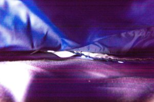

Hello guys, I’m new here. I actually signed up for an account because I also wanted to share with everyone about the problem of Canon 5D Mark IV. I have known and read about the defect for a while, but I didn’t have time to check it. So I finally gave it a try.
The lens I used for the test was Canon 24-70mm f2.8 L II. At the beginning, I switched to MF at 24mm and adjusted other specifications to f22, ISO Low 50, 2 minutes. Then, I covered the camera with my jacket to make sure it was around 95% in the dark.
After transferring the file to the laptop, I converted it with DNG converter. I pulled Exposure to +1, and +100 for Highlights, Shadows, Whites and Blacks. The final result is this. What the heck are those streaks?

The "defect" can be reproduced in extreme conditions with any camera but on 5DMiv the noise pattern is colored and linear. The experiment was done with extreme negative exposure compensation, aperture closed:
- 5DMiv f22, ISO100, 30sec, exposure -5
- 7D f22, ISO200, 10sec, exposure -5
- Sony RX100 f11, ISO 100, 3,2sec, exposure -3
and "amplified" with +5 exposure and 100%shadows recovery. Sony underexposure was limited by camera capabilities and the obtained noise pattern is mostly white.
After a month of 5DMiv and one week of tests it is for the first time I can obtain this colored noise pattern.

Alex_M said:
it almost sounds as if: the longer the exposure ( 2 min. long exposure in this case) the less shadow push is required for the phenomenon to present itself?
Yep, that is because the longer exposure is needed because of lower light levels which means lower signal to noise ratios which means more noise in the images. If you have to have the shutter open for 2 minutes the light is really, really low. Add to that the longer the shutter is open the more thermal noise there is in the sensor which adds to the problems.
Which is why shooting a sunset scene at 1/20 sec and lifting 5 stops can be quite different to putting your camera under a coat and exposing for 2 minutes and lifting 5 stops.
And all this is why some recommend that rather than shooting at ISO1600 for X seconds it is sometimes better to shoot at ISO 3200 for X/2 seconds. Or, if feasible, shoot at ISO 3200 for X seconds to overexpose (to increase signal to noise ratio) and bring it down in post processing.
It is one thing to identify a problem (anyone can do that), another to know how the camera works so you can work within the camera's limitations.
