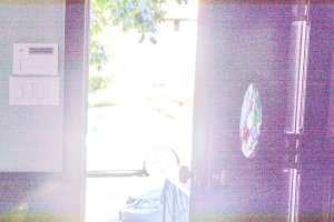

Mikehit said:
AnnWei said:
Underexposure 3ev then push up 3ev in LR, +100 shadow, and then the banding showed up.
So about a 6-stop push then?
How about you take a normal scene, not underexposed and then push the shadows 100%. Because that is what I would do in real life.
See how that works.
Actually only +3ev in LR, which means make the photo return to +0ev as the auto-metering of the camera.
I don't know how to get +6ev in LR.
Hello, I can get this banding by going +2 on the exposure and 100% shadows.
But only is the histogram is clipped on the left indicating there is no data there anyway.
Seems like a non issue on that basis tbh. If there's no data there all you do is get amp readout glow.

AnnWei said:
Mikehit said:
See how that works.
The bits that have banding are the shadows. You are pushing those by three stops then you are lifting the shadows again by 100% which is another 3 stops (or more). So you are pushing the non-shadows by 3 stops and the shadows by 6+ stops.

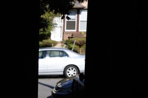

actually, I take it back. I could reproduce it. but man, in real world, i would NEVER do this. would be interested to see other cameras with this same test. I dont think in my 40000+ 5d3 shots ive ever done this, even in a purely test environment. oh well.
