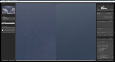

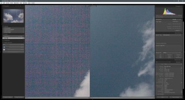

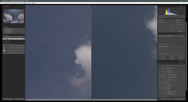

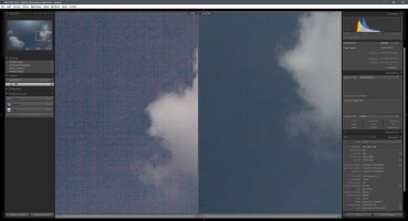

For comparision i have compare 5D2 vs 5D4.
If you see banding after +5ev in post i think it's normal because you can see some banding with 5D2 just+2ev.
But my 5D4 you can see banding in some underexposure image without increase exposure in post.
I agree that if you want to buy 5D4 you should wait if you can.
Crop 100% Noise reduction tab in Lightroom turn off.
Left side 5D2. Right side 5D4
Under 2 ev and +2 ev in post.
Under 3 ev and +3 ev in post.
Under 4 ev and +4 ev in post.
Under 5 ev and +5 ev in post.
