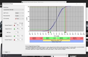

Great question.
I used Sekonic DTS software and X-Rite Colorchecker Passport to determine the DR of my camera and the clipping range. Software is available for download on Sekonic website and is used for light meter to camera calibration.
In the process of creation of custom camera profile, I took 3 shots of the X-Rite colorchecker Passport
At -3Ev , 0EV, and +3EV. Then, all 3 images were loaded in Sekonic DTS for analysis. DR of my camera was identified being 6.5 EV. That's in 10-250 range. Please see the photo attached.
In reality, clipping occurres a bit earlier than that. Therefore I have adjusted clipping margins to 20-245 -as it was recommended to me. The end result was : 5.3EV clipping range ( -2.3ev middle grey to shadows clipping and 3.0EV middle grey to highlights clipping).
The takeaway from this test is: I can spot meter for extreme highlights and then dial in up to +3 stops of exposure compensation before my highlights will clip at ISO 100 or open up aperture or shutter by the same amount of stops. I usually do 2.5 EV just to be on the safe side. Oh, and my clipped highlights in camera warning ( the blinkies) comes up much earlier than that. roughly about 1 stop earlier than they really should :)
I wish that I had 9.2 stops of useful photographic dynamic range to play with. That would give me an ability to open up shutter or aperture by 4.5 stops for the ETTR. unfortunately, it is given that I cannot push my extreme highlights exposure by more than 3EV so it seems that DTS software gets it right: 3 stops up and 2.3 stops down for me.
Subsequently, I transferred my camera custom profile to my Sekonic 478 light meter. That gives me an ability to see where my middle greys, shadows and highlights are and if I need to consider multiple exposures for the scene. I take incident light metering and then spot meter extreme highlights and shadows. Takes half a minute at longest.
It saves me time and pain in post. I like to be in control rather than guessing :)
P.S. I compared my results with others and they are within the range for my camera. I shoot RAW only. One can download Sekonic DTS software and conduct the test with its own camera.
P.S 2. Sony Exmore sensor apparently comes up at about 6.5 EV usable DR - clipping range. Not a big deal. just about 1.2 EV better than Canon 6D. Nothing to call home about.
P.S 3. if you look at the graph, there is definitely about 9.2 of DR available if measured from 0 all the way to 255 but they recon that DR should be measured for 10-250 range and clipping point range - or usable DR is within 20 -245 range. ( likely monitor / print process gamut limitation? not sure.. will investigate when I have time).
neuroanatomist said:
Alex_M said:
And.. unfortunatelly my 6D's clipping (shadows clipping to highlights clipping) range is only 5.3EV at base ISO. Substantially less than 13-14 stops...
May I ask how you're making that determination?
DxO's quantitative measure ('engineering DR) puts the 6D at 12.1 stops of DR at base ISO. Bill Claff's more conservative and probably more useful calculation of 'photographic DR' is 9.2 stops at base ISO, and that is essentially matches what DPR gets with their empirical measurement based on shooting a Stouffer transmission step wedge.
So if you're seeing only 5.3 stops, four stops less DR than a 'real world' calculation and a matching empirical test done by different reviewers, something isn't adding up correctly.
