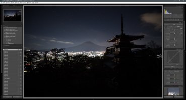

JukkaS said:
Hi all!
This picture shows the problem pretty well. This was shot 5 steps under as RAW (ISO 100), then to LR and boosted exposure 5 steps back + shadows up. This is of course extreme, but the picture taken the bright side on the right did not show these "stripes" at all - actually amazing results without these stripes. There is no noice reduction used.

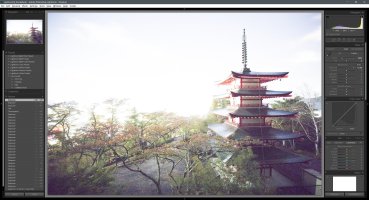

Please read the thread and check the original video from Youtube. The point in putting this to extreme is just to highlight the issue. As I say in my other post, a guy managed to get stripes in the sky with his 5D4 just by pushing the exposure 2 stops - nothing else was needed. Actually the problem shows without any boosting with a good monitor.
It has been mentioned before that the phenomenon potentially could be seen in the corners of normally exposed and corrected for vignetting image taken with new Canon 16-35 2.8 L III lens that exibits strong corner vignetting at levels as much as -4EV. I have no concrete evidence to support this statement but if thats the case, then the argument that the phenomenon could be reproduced only in rear cases involving extreme image manipulation seems to falling apart.
Personally, I believe that Canon will be vocal about this issue once the cause was identified and solution was developed both at technical and business levels. But what do I know, anyway...

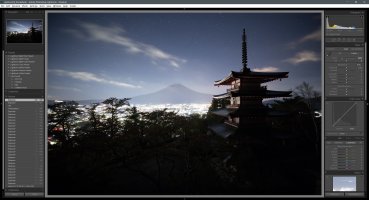

I also found the problem when i take too much under picture and bring up exposure later in post.
(You can see purple strip when + exp just 1-2 stop but i + 5ev for easy to see it.)
pic 1 ISO 1600
pic 2 ISO 1600 +5 ev purple strip at bottom
pic 3 ISO 3200
pic 4 ISO 3200 +5 ev no strip
I hope this problem is just some raw compression problem or software problem not sensor problem. :'(

I just pick up some of my image that can show the problem. I actually don't use the image.
It will be a problem when extream contrast sittuation like night scence with some bright lighting landmark.
When you have to under exposure to keep some hilight unclipping. I can see it with under exposure imeage even no exposure adjustment in post (especially night scene) .
