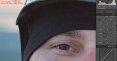

Here's a self-portrait taken at ISO 400 and then pushed +0.65 EV and only +40 shadows.
My hat is flat-black, it doesn't have rainbow colors on it. That's just Classic Canon banding! (and lots of weird noise in general)
Taken on a 5D Mk III.
This is what I keep trying to say. You don't even have to push it 6 stops to see the noise.
