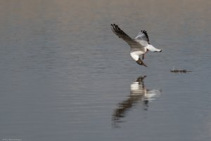

Got my camera back from repair yesterday. They said all the hardware is within spec and that they adjusted and checked the focus. It was late in the afternoon and very cloudy so I haven't had much of an opportunity to determine if it's working better now or not.
Took a bunch of shot during lunch and was amazed with how many keepers I ended up with. Here's a few I quickly processed. Nothing spectacular but miles apart from what I was getting before:

out of curiousity, how noisy is that osprey when it's flying over in that mode?..
We're right on the flight path out of Marine Corps Air Station Miramar so we get lots of airborne traffic. The Ospreys aren't much louder than any of the helicopters and much quieter than any of the jets.
When these guys fly over we have to pause meetings :)
