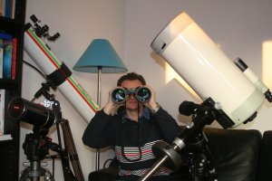

Well for people looking for high quality image with long focal; I strongly suggest Telescopes...
In fact, that lens seems to follow a Maksutov Cassegrain design and plenty of Maksutov Cassegrain Telescopes are sold at much more decent prices...
from $900 for 90mm Diameter to $2500 for 180mm Diameter.
And just to prove, I have some of these telescopes home.
Bottom Left: Questar 3.5' with Zerodur Mirror. Excellent quality. Diameter 90mm Focal 1400mm. Normal price was $4000, I paid 2nd hand €900
Top left: Perl 115*900 not the best for photography
Bottom Right: Takahashi Mewlon 210: Diameter 210mm, Focal 2200 mm. Normal price was €4000, I paid 2nd hand €1800.
And astronomers have developped ALL SORTS of adapters for any Camera body.
