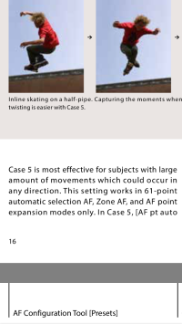

Remember that AF Cases have less or no effect if used with single point focusing.
"Remember that AF Cases have less or no effect if used with single point focusing." Not disputing this, but do we have any Canon commentary illuminating this? I've found single point expansion to be challenged by a bird on a tree even though I started with the initial point on the bird's head.
Jack
Jack
Yes, Canon also confirm This:
http://cpn.canon-europe.com/files/education/technical/eos_1d_x_explained/AF_guide_EOS-1DX_eng.pdf
