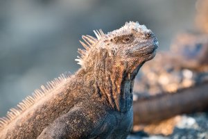

Just got back from a great trip to the Galapagos Islands. The principle purpose of the trip wasn't photography but I tried to squeeze in what I could. I wanted to share this image as I continue to be blown away by the performance of the 1DX mark II. This is an iso 10,000 file and I was impressed with the amount of retained detail, noise, etc.
EF100-400 f/4-5.6 IS II USM
1/800, f/7.1, ISO 10,000

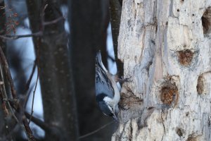

This is super. I don't feel I'm getting close to this level of resolution/performance and suspect it's got something to do with using the 400 DO II X2 III combo with the 1DX2. I'm ever so close to sending the combo into Canon. My main issue seems to be focus inconsistency between what I get with one-shot & AI servo with spot as compared with full auto, assuming focus falls where intended.
I'd appreciate any comments on this shot at ISO 10,000 (800mm, 1/640, F9, +1/3, spot AF) which is one of my better (usually the focus point will fall like this but the sharpness will be worse despite me messing with AFMA for hours) examples without any cropping: DPP noise reduction/sharpening default values NR L=5 NR C = 9.8, SH ST=3, F =0 THR =3, DLO =65), followed by a shot with those settings reduced to zero.

Jack you need to be very careful when you look at other images and think yours isn't as good IQ wise. The image by ethane was shot in open contrasty light and the texture of the scales is enhanced by the noise, so it looks way sharper than it is, it is also a very modest crop of the entire frame, 16 of the 21 MP.
By contrast (literally) your image has much flatter light, the texture of the feathers is not in harmony with the noise and your crop is a mere 3.5MP of the 20 original.
I'm not saying you are not having issues, I am saying don't compare shots like you are. Take the time to set up some tests for yourself, if manual focus in good contrasty light is giving you much better detail than AF is then you might have an AF issue. If manual focus is not giving you the kinds of results Brian gets at TDP on test targets with good technique and light you might have a lens/camera issue.
To illustrate that different crop issue, here is a screenshot of both the images side by side at the same pixel level. Any IQ comparison between the two (invalid though it is because of the differing light) must be done at these equal sizes.

Thanks guys. Scott, I hear you but don't have the experience to fully appreciate the nuances. I have indeed been trying to sort this out but I'm immersed in work and when I try we have cloud or cold that have worked against me. Frustrating to say the least, since I want to be sailing freely when spring arrives here, not dealing with camera issues.
I have many shots that seem to present issues but often they are high ISO, making evaluating focus challenging .... oh well. When I set up for AFMA on a sunny day and ran through many shots it led me to believe about +9 was correct. Bird shots said no way, it's off.
So more sequences in different circumstances and for sure it's +4, BUT still no consistency in real life subjects. Like I have shots with the spot focus square right on the eye and that area is obviously not in focus, unless there is movement, but I didn't think so. Because I don't have sun I'm at say 1/1000 F8 with 800 mm and cant get ISO below maybe 2000+. Oh, well. Still, I'm learning various things such as camera button programming/operation etc., in spite of the challenges.
