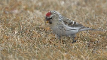

Something has happened relative to the sharpness of my shots but I'm not quite sure yet. I think this shot shows clearly that my AFMA is at least close now. It's F10 1/1250 ISO 1000, 100% crop of 400 X2. It appears that my previous back lit photos are indeed part of the problem regarding not looking sharp. This has some fill flash.
Thoughts anyone?

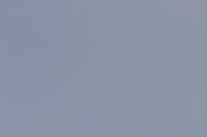

IDX2 PROBLEM!! I saw a thread on Art Morris's blog about oil shatters on the 1DX2 sensors. So I checked the sensor on my new 1DX2 and after less than 600 images, it already has oil splatters. The oil splatters appear as droplets and are difficult to clean. Importantly, many owners report that the problem persists after cleaning and Canon seems to offer no solution.
Check your sensor by shooting a grey or blue sky with any telephoto lens in AV mode. Go to manual AF and defocus to close focus. Jpeg is fine for the test. View the images at 200%.
This problem is wide spread. My neighbor just checked his sensor and also has oil platters. I encourage anyone affected to contact Canon and complain. Hopefully, Canon will develop a solution to the problem and not just clean the sensor.

Mikehit said:
To my eyes, assuming you focussed on the eye, the 'correct' blades of grass are in focus.
The bird is still a bit fuzzy - how heavy was the crop? Shutter speed?
Cropped to roughly 4/20 MP and pp as best I could in DPP sharpness 4, DLO 70, no NR.
If I hadn't done so well with my 6D and 300 2.8 II X2 III I probably would be none the wiser.
Jack
This is just not an issue at this point. Look at some sample Nikon D600 images to see what a real oil splatter problem is! https://garypoulton.com/tag/nikon-d600-sensor-problems/
As Mikehit points out and I agree, if you didn't notice it before, and you have to take a test image at uncommon apertures in uncommon exposure levels and then enlarge them to unrealistic zoom levels to notice it, can it really be called an 'issue'?
Relax, takes pictures with your camera, enjoy it's capabilities and remove any spots of dust or oil actually visible in your images at output sizes.

Mikehit said:
If you have to magnify the image to 200%, is it a problem? You can say 'it should not happen' which is fair enough but if you had to do this to notice the droplets - is it a problem?
Why do you need to use a telephoto lens in AV mode?
I tend to agree, especially after PBD has chimed in that dust and spatter generally is not that big of a problem. I have quite a bit of spatter and in certain cases with some cropping it's showing. Here is my shot of the sky (crop of the top left 1/4 of FF).
I had oil spots on my 1D4 that I cleaned off using the VisibleDust kit for oil and I had to repeat many times, including purchasing numerous spare wipe sticks to get it half decent. Not something I plan to do again since I'm not the steadiest guy.
Jack

Scott, that is indeed a situation that would turn my stomach. I'm just too fussy a guy to be able to pretend a real problem is not a big deal.
However, I agree with the sentiment that pestering companies about very small issues is simply contributing to escalating costs and is wasteful of ones time.
Early on after I got my 1DX II my sensor was very dirty as well. I cleaned it once and the problem didn't appear again nearly as quickly or to the same extent. For me the issue has seemed to diminish with time. Additionally, as I am usually shooting with large apertures on this camera (wildlife, etc) I rarely notice the issue. Interestingly, my 5DS R seems almost completely resistant to developing spots on the sensor. After 2 years of ownership and never having cleaned it I pretty much can't find any spots on the sensor even when looking hard!
I'm not sure complaining to Canon will produce much in the way of change. I would pick up a few sensor swabs and clean the sensor every once in a while. If your experience is like mine after a couple cleanings the issue will have greatly diminished or disappeared.

WRS, I've cleaned my 6D sensor of dust - easy enough. However, when I cleaned the 1D4 that had oil spots I had to repeat numerous times using the appropriate visible dust solution and had to buy another kit and extra swab sticks, not cheap where I live. As a result I think my sensor would have to be pretty bad before I'd want to try that again. Perhaps I haven't done enough cleaning to develop the knack/confidence??
