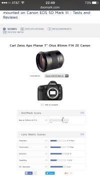

Long time reader, first time poster.
I have a question about the above.
What accounts for the loss of P-MPix in Canons vs. Nikons cameras with the same lens?
I mean with the above numbers, for example the Otus 55mm shows 33 P-Mpix on the Nikon D800E and 37 P-Mpix on the Canon 5DSR. Sure 37 P-Mpix is greater than 33 P-Mpix, but thats 13 P-Mpix loss on a 50 MP sensor, vs. only 3 P-Mpix loss on a 36 MP sensor. Thats a 26% loss on a Canon over a 8% loss on a Nikon, if there was a similar 8% loss on a Canon it should show 46MP sharpness no?
Surely there can't be 26% loss between sensor to output???

Welcome to the DxO mystery hour!! Let me blow your mind even further. Go look up lens scores for the Same Zeiss glass on the 5D3... Go look up several of Canon's top ranking L glass. The loss ratio is far lower. Somehow the loss ratio magically jumped to what you said on the 5DSR...
