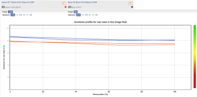

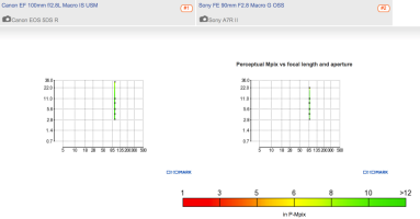

You know why Sony has a higher sharpness score? Because the Canon stops down to f/32 while the Sony stops to f/22.
I'm not saying you're wrong, but how do you know that the sony wouldn't have a higher score even if the Canon went to f/22?
Their sharpness charts, to me, have such poor presentation that it's impossible to tell what the data are. Which shade of green of the thin line against a white background is darker?
Even if you click them, the charts are practically unintelligible. Which lens is sharper wide open rather than averaged over the aperture range? I have absolutely no idea. They should include a mouseover readout.
Their acceptance charts at least show some differentiation.
