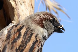

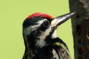

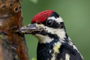

Most lenses give great results with the image filling the frame. You see what a lens can do by looking at 100% crops of a small bird occupying just a small part of the frame, just like in the last posts. Here are three 100% crops I took with my 2.8 300mm II + 2xTCIII last weekend, with just a few hundred pixels each way occupied. I posted a few more today in the BIF thread. It is a great combo (and a nice back up for my Tamron 150-600).
Jack Douglas said:
Please define 100% crop again - poor memory! :-[
Jack
Hi Jack
100% crop means that you have cut a section from the full frame and haven't reduced it in size. So, 1 pixel in the crop = 1 pixel from the original.
Always good to correspond with you.
Alan
