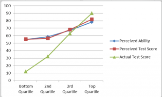

Have gone through the POTN thread and some people there are even implying that people "without" this problem do not know how to use their cameras. So, I guess the people posting excellent shots on the 70d sample thread don't know how to use their 70ds.
Ah - the dreaded "Dunning-Kruger Effect":
"The skills needed to produce logically sound arguments, for instance, are the same skills that are necessary to recognize when a logically sound argument has been made. Thus, if people lack the skills to produce correct answers, they are also cursed with an inability to know when their answers, or anyone else's, are right or wrong. They cannot recognize their responses as mistaken, or other people's responses as superior to their own."
"The Dunning-Kruger effect occurs where people fail to adequately assess their level of competence — or specifically, their incompetence — at a task.
This lack of awareness is attributed to their lower level of competence robbing them of the ability to critically analyse their performance, leading to a significant overestimate of themselves. Put more crudely, they're too stupid to realize they're stupid."
