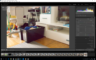

Now I would like the answer.. Mr bclaff is this 11,8DR or 8-9 PDR ?? Thx
Look at all the noise on the plastic container in the middle of the photo. Or on the TV screen.
This noise is the reason why the 6DII dynamic range measures lower than the 5DIV, for example.
Apply some noise reduction to see how this noise cleans up.
The 6DII's noise is reported to be more random than that of the 5DIII and original 6D.
So, it should clean up better.
