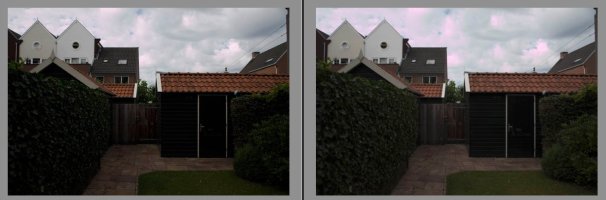

I just took a picture at 160 ISO
I got a strange result in LR when using the graduaded filter to bring down the highlights and exposure in the sky.
The clouds become pink....
I am puzzled. It seems I do not have a good copy of this camera.
What do you think?
https://www.dropbox.com/s/chl2j77x23nvk7t/IMG_0134.CR2?dl=0
EDIT: if you try the same steps in LR with 100 ISO you don't have pink color in the sky.
https://www.dropbox.com/s/1u5l62ezto6nwm9/IMG_0133.CR2?dl=0

Re: Canon EOS 6D Mark II Dynamic Range Talk & Sample Images
I am getting crazy from dropbox. The file is uploaded but still reports a 404 error when using the link to download.
Here are two screencaptures
- file _0133 at 100 ISO with heavily reduced higlights in the sky using the gradual filter
- file _0134 at 160 ISO - copied the photo setting for reduced highlights
No other settings were applied. All settings left to default
The ISO 160 shot is clipped in the highlights, according to Rawdigger, in the blue channel, and in one of the two green channels (that's weird to me, I thought that the two green channels usually clip at the same time ? But maybe there is something I don't understand here).
Then, this is combined with Adobe's particularly rubbish profiling of the camera. If you switch to the "camera neutral" profile, for example, you will see a noticeable improvement. If you export the file as DNG and import it in Capture One (which doesn't support the 6DII yet, so it's only going to get better in C1), the pink issue becomes quite negligible.
The following photo (your ISO 160 shot) has the same settings applied, except that one uses the "camera neutral" profile, the other "Adobe standard".

neuroanatomist said:
@candyman – could be LR (wouldn't be the first time Adobe handled new files badly), I'd try in DPP to see if you get the same issue. If so, contact Canon. Else, contact Adobe.
Thank you Neuro for your suggesting.
I opened both files in DPP 4.6.30. I don't work that often with DPP so I am not sure how to partially process an area of an image in DPP. But I decreased the highlights and brightness in both images and the _0134 image does not have pink clouds like it has in LR.
It really looks like it is an error in LR 6.12 on the 6D MKII processing. But, I am not an Adobe & processing specialist. I am not convinced yet.....I want to...... since I hate to retrun the camera :(
