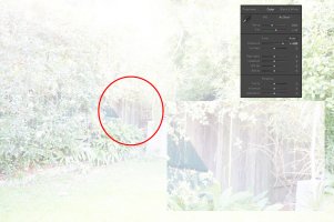

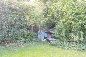

To continue my argument from the previous thread 6DMKII DR thread.
The DR may not have improved but the quality of the files has vastly improved.
Sorry to again explain my main issues with the 5DMKIII but...
I found (not always) that I would run into problems with banding, colour noise and purple muddy shadows if I lifted more than a stop which in high contrast situations I would say is fairly common.
The colour noise was always my most hated issue with the previous tech, I would have the slider up to 35-40 on colour noise and the smoothness up to 75. Even at base ISO I had issues. The 3 issues were really a pain and would increase PP time significantly. Although not all the time but with dark wedding venues where you cant light the room, or in high contrast situations like wildlife in rain forests with dark shadows and beams of light through the canopy it was very hard to expose correctly and inevitably you would expose to protect either side.
Anyway as previously noted this image is a 200 ISO image so should be on the better side of the scale.
This was one of the first REAL raw files posted by an Australian guy on the DP forum and have now been deleted. I have posted this because its the first half decent contrast scene posted to test if you could push. Shot into the sun and a dark corner scene.
Here is a image that has been pushed 4 stops and has a 100% crop to show the quality. There is no NR or sharpening just the standard lightroom profile.
As you can see there are none of the above issues like the 5DMKIII which shows a considerable improvement. The difference between a keeper or a binner.
I appreciate it should recover well at 200 so there is also a 3200 ISO image too. 4 stops at 3200ISO and again no banding, colour noise or muddy purple casts. Ok it has noise but its a 3200 file pushed 4 stops its a silly push.
There is something going on here I haven't done anything but an exposure push and these real world images show a very different result to the ones posted by DP.
For all you who are on the fence and are disappointed. Its just one aspect and ok it may have the same DR but these files are miles more usable because they are so much cleaner. How often will you do a 4 stop push on a 3200ISO file. As you can see on both they are completely blown out. This is because they were exposed correctly. So I dont know how it would perform if you did shoot your lens cap and push it 4 stops ;D
But in real world useage with good exposure this IMO is a really great performer and its not showing the tell tale signs of the old cameras from these two examples.
This is why it makes me think that camera used for the DP samples is a pre production the files were taken on the 14th July. Adobe released its Camera Raw support on the 19th. Take that what you will.
