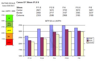

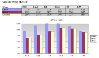

Photozone just posted their results:
http://www.photozone.de/canon_eos_ff/905-canon_50_18stm?start=1
It would appear the same optical formula (as others have said) isn't telling the whole story. It's a shade sharper wide open and slightly better in the corners throughout.
Not bad at all for such a cheap lens.
