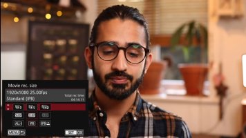

What could I be possibly be doing wrong? I have tried everything my mind could think of

Thank you for the suggestion, but I am using a proper card. Cfast! And, when I set the camera to shoot video with simultaneously proxy MP files, it does not allow me to shoot at 100 fps. I am sure this is an operator error as my R5 does all of this rather easily. :-(

For whatever it's worth on my 1DX Mark III when I select RAW video with proxy recording on the second card, the high frame rate option is grayed out for me as well. See below. I have San Disk 512 cards so it's certainly not an issue of speed. But can you take a picture of the screen where you don't see the frame rates you are wanting to select?

You know I just thought of something. I would imagine the R3 is is similar to the 1DX Mark III. When you select Raw recording with proxy from your yellow menus it will change the options that you can access in the Red menus to select your video type. To select all options you need to make sure that the Yellow menu Raw with Proxy is not selected and then you should be able to see all options on your Red menus. Hopefully I'm making sense.

In the yellow menues there is no mention of resolution anywhere.
On of the reviewers on youtube (Gordon, I think) mentioned that the 6k resolution is under the '4k' icon.
Do you have your camera set to HDR mode? That locks out a number of things and isn't actually related to HDR video.

Even after I turn off proxy in the yellow menu, R3 does not say
No, it is not on HDR. I think I will shoot the so called 4k under the 4k icon and check on my computer and update you all...

This is correct: there is no "6K" icon. 6K resolution is under one of the 4K icons, as you have indicated. You will know it is 6K because the resolution will show as 6000x3164, despite having selected the 4K icon.
