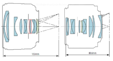

@YeungLinger I'd suggest watching some of the lens teardowns on Lens Rentals. It seems like there's not much dead space inside these lenses. The high-impact plastic is sturdier than metal (resisting bending, etc.) but also takes more space for equivalent strength. I recall Lens Rentals saying that Canon lenses have the most spots for micro-adjustments during manufacture to get every part better-aligned. The auto-focus motors are wonders of compactness on their own yet really contribute a lot to girth.
As a separate matter, the move to mirrorless, and putting the lens back closer to the sensor, has generally caused a trend I've seen noted in a Canon USA white paper that the best lens designs for RF have much larger rear elements, as a rule, than the similar EF lens, but don't need as big a front element. So while the front element size may seem smaller, it's not that there's nothing behind it that is big. Here's a comparison of the EF35/2 and RF35/1.8. If you try to estimate the amount of "non-optics space" in the lens I don't think it's night and day different.
