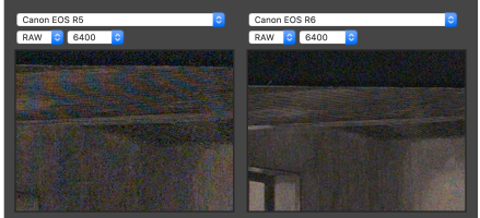

to me its more like moire effect rather than sensor banding.
Me too - I was around during the Great Nikon D200 Sensor Banding Wars, and the famous Battle Of The Canon 7D, and this isn't like any "sensor banding" they ever manifested. In fact, at 300% view (100 ISO again), it's definitely moire:
Moire is easily dealt with. And it's the price you pay for light anti-aliasing. A finely cross-hatched area of a lino-cut style print like this is just where you'd expect to see it.
We're seeing the same kind of false colour (to a far lesser extent) that's shown in the second image example on this page:

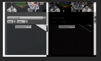

and the reason is (likely): left and right files are identical, the same file being compared..due to a human error :) I found a spot in the image that is purely noise pattern and it is identical in both samples... I am not going to bid my house on it. but... it is a miracle otherwise.. not what TDP samples are showing. there is a difference and noticeable in the level of details available at ISO6400 specifically. R6 is slightly more detailed.
But when they are not normalized the images are different sizes, the file names are different and the file sizes different. At this point though I'd still be wary of minuscule differences, nobody has a well developed RAW converter and that will only get better, but initial results show no practical differences at high iso between the two when normalized, which is exactly what should be expected.
I was interested in this possibility so I screenshot the two as that is the only way to compare what you think the issue might be (as any link might go to a different but correct file). Anyway I opened it in PS copied it to another layer and put it in 'difference' mode. When moved to cover the other picture it should show as black but it doesn't, the two files even as displayed are not the same file.

but back to your request. Here is a screen shot. (R5 and R6)View attachment 191536
Same thing done with this screenshot to get the best (darkest) result from the patch, they are not the same file.
To be clear, if the files are the same the result is pure black, it might look like they are but they aren't. Here is what it should look like if they are the same file, this is the screenshot with a copy on top turned to 'difference' mode. pure black every pixel.
Yup, I stand corrected. files are indeed not the same. apologies. .

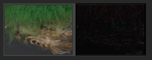

1. +++With the claim about the R6 having more detail, you are referring to the word 'green' having higher contrast edges on the R6? That is not necessarily an indication of detail, especially since small differences such as these can also originate from the scaling methods used.
A.M.: it well may be that you are correct and I am incorrect. I looked at a number of methods that Bryan used: P.S., DPP... there is a difference. Is a small difference but visible to my eye. And it is not only a higher contrast edges... not only an acutance... There is a small difference in how details were rendered.

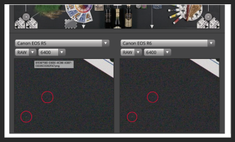

I'm going to throw out a WAG here and say those two spots are dust on the surface of the test target?
Reactions: SecureGSM
privatebydesign
I don't preorder, I'm not a paid beta tester!
Jan 29, 2011
8,860
2,791
120
Agreed, and in itself is a demonstration of the similarity. Both managing to resolve such small and non contrasting spots as well as each other.

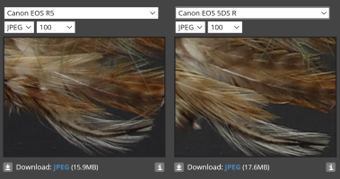

Interesting to me is that the 5DS vs R5 comparison looks like the R5 is rendering things sharper even despite the 5 megapixel less resolution. Maybe Canon is right that the new 16-point low pass filter is making things sharper despite the lower resolution, or it's just adding more sharpness to Jpegs. The 5DS R definitely looks a little bit mushier in this comparison of the two.
I don’t think you can tell much at all from jpegs, but the file size would indicate there is more detail to be had in the 5DS R.

This is what I've found in the three years or so that I've been using the 5DS. 20mp on a FF is high resolution in its own right. To see the (small amount of) extra detail resolved by the 50mp sensor you have to view it at full size. Once you reduce the output size down to that of 20mp the extra amount of tiny detail has become too small to see anyway. So for me, the moral of the story is very high mp sensor for very large output or very heavy cropping. When I started using the 5DS I thought I was getting better colour definition and fidelity with the very high mp, but now, three years on I think this was due to making the classic mistake of not comparing sensors of the same generation.
Apr 17, 2017
269
309
Placitas, NM
www.flickr.com
5Ds(R) was amazing when it was good and terrifying when it was bad. About the most succinct review I could give of my time with it.
