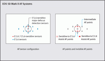

Seems that a lot of people don't know this: "The AF system on the EOS 5D Mark II includes 9 visible AF points and six invisible assist points, for a total 15 points concentrated toward the center. [..] The purpose of the supplemental points is to enhance the camera’s subject tracking performance by filling in the gaps between the highly sensitive central AF point and the 8 adjacent linear sensors."
Edit: And: "[5DII] The outer points on the extreme left and right are actually located at the same positions as the corresponding points in the EOS-1Ds Mark III, giving the camera a wide field for detecting moving subjects crossing the scene or improved ability to focus on off-center subjects."

Yeah, just like the 5D: "The EOS 5D camera has a new 9-point AF unit
with six Supplemental AF points, a new AF
algorithm and new AF circuitry."
5D whitepaper here: www.usa.canon.com/uploadedimages/FCK/.../EOS_5D_WP.pdf
(unless I missed something...if so, my loss :( )
Sounds the same as the original 5D, and from the picture, it didn't look like the assist points made the AF area any wider. That was one of the problems I had w/ the 5D. Maybe I missunderstood the pictures, but I would like them to be wider and cover more of the view finder. Like I said, I actually tried the 5D and it just wasn't enough for me to part w/ more money. No big deal. Beautiful camera, beautiful images, but not enough of an AF upgrade/solution for me. My money (and again, just saying this was the way it was for my situation) was better spent on lenses at that time.
Honestly, if they don't upgrade the AF w/ the next model, then I will probably just get that model anyway since I have a nice set of lenses now, and I will probably need a camera by then.
BTW- thanks for the link and the image...it is helpful :)
