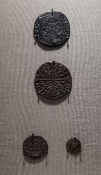

My S and G cameras have had a macro mode, but I haven't messed with them enough to know what is going on with them. I think I can focus just as close in the regular mode. If I am home, I can just use my DSLR and 100mm lens anyway. And when traveling with the G cameras, I rarely need macro distances. This exhibit of coins in the Tower of London was the closest I can recall wanting to get:

From looking at the RAW file from the G7X II, I conclude that the coin picture above was taken at 30% magnification (more or less), so not really macro, which is to my point.
