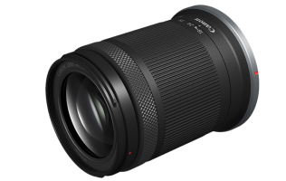

Wondering whether *any* of these RF-S lenses will have a control ring?
Seems unlikely given their small size and lowish prices.
Illustrations of the 18-45mm and 18-150mm appear to show only a zoom ring and a focus ring.
Absence of a control ring means only 2 direct control dials available for settings on the R7. Typically people will assign these to aperture and shutter, which means having to "press a button and dial" to access ISO and exposure compensation.
On other lower end RF lenses the focus ring doubles as a control ring, there’s a switch on the lens for that.
There are current RF lenses where the ‘one ring’ can be set to function as either MF or control ring. The RF-S 18-45 doesn’t appear to have the switch that @koenkooi mentions. Perhaps Canon will have the physical AF/MF switch able to automatically change the ring function from control to MF?
Agree on only two camera dials, ergonomically that is a big downgrade.
