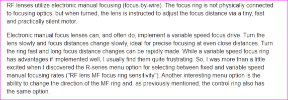

It's not quite a ring, but a few solid stops. I can imagine if this is focus bracketing, every step is a defined amount different backwards or forward from the focused point. That would let you make your focus brackets in specific amounts, and if it's electronic, you could probably define how far of focus every step is.

The arrow focus you describe just sounds like Canon's manual focus guides, which should be available regardless of the lens, as long as the lens is detectable for the body. So that's pretty much a given.

I have no idea what SA means, but I was thinking along the lines of something like a fine focus adjustment to get more precise focus as it is a macro lens at 100mm. If it is I still don't know what SA means. I am only throwing a suggestion out there.
It could indeed be kind of a "focus ultra-fine tuning" for manual focusing.
Therefore the + and - markings.
You don't really need focus fine tuning with a RF lens, you can variable focus speed so that it can focus in very fine increments. Ideal for manual macro focusing.
