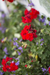

I have often struggled with red objects in my 5d3. I wrote last year about it but did not get any replies. Yesterday while trying out my new 85 1.2 ii, I saw the same issue.
Red flowers come out in an over saturated red haze. The other colors seem saturated just fine, but the reds are over powered so much that the flowers lose detail.
I can reduced saturation in LR, but then the whole image looks washed out... the issue is only with reds.
If I reduce just red (Red channel only) , then it lacks punch, although I get back details in the flower...
Has anyone else observed this?

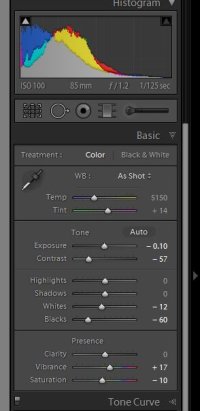

Finally I get it where I have good saturation AND details. but takes me 5 minutes to dial it in LR with these settings:
There has to be better way than having to work on the reds so much.
These where all shot/ processed in RAW in LR 4.4

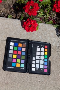

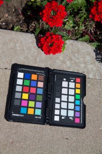

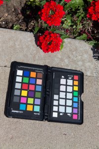

I just had this fist-fight with my 1Dx; I found that calibrating colours with a colorchecker passport got the shade right, and then selectively dropping the exposure on red bits by around 0.6 got them sorted. Oddly enough it wasn't the reds that shifted on the histogram, but blues.
The images in order are as imported; lens profile; color profile and finally the upper flower dropped down 1/3 stop with a brush stroke in LR5.
Then again to compare them back to back for this one I might leave the exposure; I definitely agree that they're troublesome. I was out shooting some red uniforms under fluorescent light a week or so ago and post on those was a real pain.

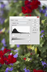

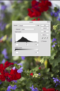

I do a lot of macro work with flowers and see this a lot, and not just with reds, but blues and yellows as well. It's an issue with the capture, not the post-processing. The camera's meter is tricked by the strongly saturated colors and while it is metering the red channel correctly, but you have underexposed the blue and green channels (see histogram), and by "crushing" the shadows, you have oversaturated those colors. If you look at the screen shots, you'll see those channels are spiking on the left side.
The solution is to use the RGB histogram mode on the camera and when you see this, bump up the exposure until the shadows are no longer blocked, probably just +1/3 or 1/2 EV. It sounds counter intuitive, but it works.
P.S. here's some information from Michael at Luminous Landscape (from Optimizing Exposure):
"For example, with a typical DSLR, when photographing a red flowers under natural daylight, the LCD histogram will typically show the red channel as blown out. This doesn't tell whether the native raw red channel is actually blown. So one doesn't know whether to increase the exposure for ETTR, or reduce it. The natural reaction of most users is to say, "Uh oh, I'm gonna blow the red channel in these flowers, so I better reduce the exposure till the red histogram doesn't look blown out anymore." Unfortunately, that's almost always the wrong thing to do. In fact, the red channel (in the raw data) rarely clips on a typical DSLR with a normal daylight exposure, because the red sensitivity is very low (about 1.5 stops darker than green). If one was to reduce exposure till the red histogram no longer showed clipping, then the actual raw red channel would be very underexposed with a poor SNR. Result: noisy red flowers!
One colleague reports that he measured the relative sensitivity of the R, G and B of his DSLR at 5500K daylight (per daylight film). The ratio between the channels was very close to (G:B:R) 5:2:1. That helps explain the reasoning above. Food for thought."
They also have a nice tutorial on a good method to fix them, if you have already underexposed the image: Restore Those Clipped Channels
