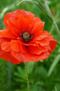

How do reds come out in your 5d3 ?

I have often struggled with red objects in my 5d3. I wrote last year about it but did not get any replies. Yesterday while trying out my new 85 1.2 ii, I saw the same issue.
Red flowers come out in an over saturated red haze. The other colors seem saturated just fine, but the reds are over powered so much that the flowers lose detail.
I can reduced saturation in LR, but then the whole image looks washed out... the issue is only with reds.
If I reduce just red (Red channel only) , then it lacks punch, although I get back details in the flower...
Has anyone else observed this?
Looks like your auto white balance is thrown off by the amount of 'green' in the photo (greens look too blue). Try a WB setting of 'daylight' or 'cloudy'. I find this gives the best overall results if shooting in a 'green' environment.
ahsanford said:
Excellent thread. This topic has vexed me on 5D3 flower work. The 5D3 has always been oversaturated on reds in my hands, and I seem to lose something when I try to rein in the reds in RAW processing.
You and others single out the 5DIII, but I'm pretty sure I've had the same problem with all the Canon cameras I own or have used (5DII and more recent models, both FF and APS-C). Is that true for you too? (I also find a related issue: even if I get reds to look right in LR, the process of exporting it to JPEG often screws up the results). For a while I more-or-less gave up photographing red flowers....
Other cameras I use/have used seem to treat red as a problem and understate it, at least when it's a component of other colours. The first time I photographed purple petunias with my Pentax K5 (I no longer own it), they came out almost pure blue, while my two Sonys (FF & APSC) do something similar, though not to the same extent (it may not be a Sony sensor thing - I'm pretty sure my OM-D doesn't do this, but it, like the K5, has a Sony sensor); so instead of taming reds I end up adding a bit of red to the purple tone in LR.

FWIW I'll join the red flower post ;D
Here's one shot with my NEX-6 and a Canon 50mm f/3.5 FL Macro (from the 60's).

Nice photo MRS! I would like to clarify what you said above - it has an effect on the exposure of JPEGs and histograms, but zero affect on the exposure itself in RAW, and it does not affect the metering.
Actually yes you're right but because it affects the histogram I think it better helps to evaluate if exposure is correct based om the output/clipping of the individual channels in the histogram. I always have my histogram showing in image review, set to RGB. In fact. being able to see the histogram is almost more important than being able to see the shots themselves.
Maybe it's the correct exposure for dynamic range per channel that counts, if something like that actually exists.
