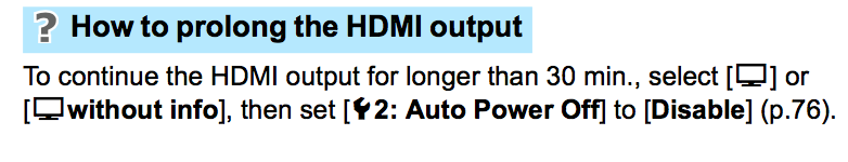

There already is, just record the clean HDMI out to an Atomos or something similar and you can set the camera to record indefinitely.
I'm looking to get the new Atomos Ninja V to record better 1080 from the 1DX MkII when it is in 4k internal shooting via HDMI out.
At 29 minutes, it stops recording. You may restart the recording for another 29 minutes, but if the program, for example, if one records Beethoven's 9th symphony at 79 minutes, there would be an obnoxious break.
I was told that it was a European law that made this a law, to protect camcorder business, if that's true.
I also know of the method of attaching an external data recorder, but, never a convenient affair.
