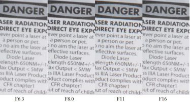

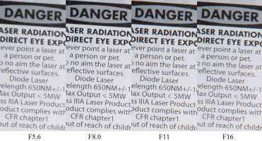

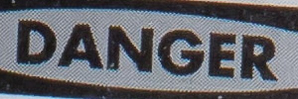

A quick sharpness test....
The goal is to see what effect the F stop has on sharpness with the 150-600 when used at 600mm
All shot with a 60D from a distance of 20 feet and processed in lightroom. All images are with the Tamron 150-600 profile enabled and with chromatic aberration correction enabled.
The target is the fine print on the back of the packaging of a laser pointer... it was the smallest size printing that I could find lying around the house.
The first image has the colour balanced, sharpness slider at 0, noise reduction slider at 0
The second image has the sharpening slider at 80, noise reduction slider at 50, and blacks level at -50. There is a typo on the picture description.... The first bar is F6.3, not F5.6.
Obviously F8 or F11 is far sharper than F6.3 and it falls of by F16. With sharpening enabled, F11 appears slightly better than F8. When you consider that I could not see the pattern around the "danger" symbol when it was inches from my face, yet the lens could pick that up from across the house, this lens is great bang for the buck!....
With all due respect Don testing a 600 lens at 20 feet is a bit ridiculous - IMO! Nevertheless many thanks for your post.
But then I suspect Can/Nik, Tamron etc are optimising their optical designs to come out well in imatest reports at 30-40 ft and may not be all that sharp at distance.
