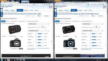

the 2nd lens on the list: sigma 18-35
you can see that the overall scores are pretty close on the 2 combos, the ff combo is sharper but both combos are plenty sharp and will give you good results with similar dof.
the ff combo is $5700 the aps-c combo is $2100
