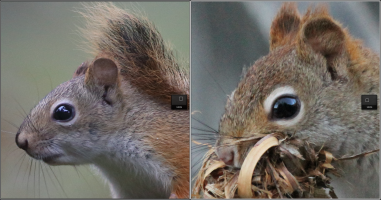

Ok, let's try that. At the risk of offending the CROSP*, below are a pair of images shown at 100%. One is from an 18 MP APS-C camera at ISO 3200. The other is from an 18 MP FF camera at ISO 6400. I'm having trouble telling which is which, the noise levels are so similar.
Can anyone help me figure out which is which? ::) ::) ::) ::) ::)

viewed at 100% means that you are viewing individual pixel on your monitor correct? 1 to 1?
