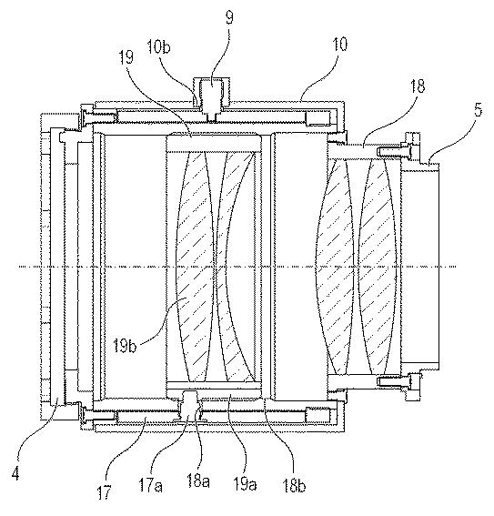

Is that 4 elements and 2 groups ? isn't that insane if it is, not a lot of glass compared to the current converters ?

I regularly switch from native to 1.4 to 2xTC during the course of shooting in a day. This TC would be convenient but with the drawback that at 1x it would degrade the IQ of the bare lens without any advantage at the native focal length because of the extra elements. Still, I suppose you would put it on only when you want a longer focal length but have the opportunity to zoom out quickly.

This is [only] brilliant [if they can pull it off without degrading IQ at 1x]!
Legend: Read without brackets for my first impression and then again with text in brackets included for the thought that immediately followed.
I don't believe 1x will be free (absolutely no loss), however if there is no appreciable IQ loss I think most will find that acceptable... as the use case from flipping 1x to 1.5x to 2x and back w/o a lens change is worth it.

Question is how much IQ is traded for size, price, and convenience. Personally, I find the possibility of having a TC for the RF 70-200mm is good news.
Sure, if the IQ was good. But even Canon;s regular converters drop IQ by differing amounts depending on the lens and on the length of the lens. A zoom converter will be worse. Sometimes it’s just better to crop.
My impression from the images and the auto translation to English is the patent is about the mechanics of the adapter, not the optics.
E.g. the "problem to be solved" is "to provide an adapter device advantageous for moving an optical element in a direction of an optical axis, for example", and "patent document 1 has a built-in ND filter, discloses an adapter device having a function of adjusting the amount of light". The text mentions possibilities of having different mounts at each side, and the connected lens' power of coverage differing from the camera's sensor size.
The patent might be generalized to cover more ground (a vari extender that's also a mount adapter), but I still get the impression the optics & their functionality is an example of what the patented mechanics could be used for.
