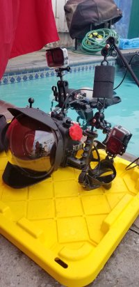

I cited this scenario in my last video. How do you keep the camera dry?
I use an Aquatica 5D housing with a vacuum port to be as certain as can be that the camera remains dry at depth. Serious gear for a serious camera. This is why many of us underwater photographers keep our cameras for so long. Housings like these cost more than the camera so whatever new camera we buy, we're committed to it.
