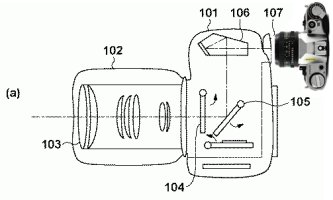

There is no such thing as a 'DSLR mode' and a 'mirrorless mode' in this patent.
There is a framing position designated as (a) in the patent (and called "preparation of photography" in the description) and a shooting position called as such and designated as (b).
index.php
In framing position (a):
- the image sensor 108 flips down to make way for both the focussing screen 104 and the mirror 105
- the focussing screen 104 (which, in the patent, is said to include a phase difference detection device) flips down to the same plane as the sensor 108 in shooting position (b)
- the mirror 105 flips forwards
- the image on the focussing screen 104 is reflected towards the prism 106 by the mirror 105.
In shooting position (b):
- the focussing screen 104 flips up, out of the optical path
- the mirror 105 flips backwards to make way for the image sensor 108
- the image sensor 108 flips up to the focal plane to take the picture (or use the live view).
Exactly. It seems several people failed to correctly understand the concept, in some cases inventing ridiculous explanations to support their misunderstanding.

Isn't this just a way of having a reflex OVF with mirror-less flange distance and thinner body ? I think someone has designed this purely for the purpose of winding up the likes of AvTvM, and the rest of the "mirror-less is the future" brigade ! Although it doesn't show it very well in the diagram I guess that this design could have a body that is about the same thickness as a traditional 35mm film SLR.
Yes for the reflex with OVF and mirrorless flange distance, not so sure for the thinner body: you still have a mirror and you add a focussing screen in front of it.
The advantage of such a device is to reconcile optical viewfinder and phase-detection autofocus on the one hand, lenses with a short-registered mount on the other hand, i.e. to only need one range of lenses for both mirrorless and reflex cameras. The price to pay is a huge mechanical complexity:
- three flipping devices that shall be perfectly synchronised,
- two flipping devices (sensor and focussing screen) that shall be perfectly adjusted to stop at the very same vertical position,
- a flipping sensor, the movements of which shall be perfectly damped.
Not to mention a phase detection device that shall be perfectly transparent since located on the focal plane...
Mistral75 said:
The advantage of such a device is ... to only need one range of lenses for both mirrorless and reflex cameras.
Why can't you do that by just making a mirrorless body with the same flange distance as an SLR body?
With DPAF you don't even lose phase detect.
