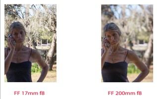

THAT is completely incorrect. That is the bit that needs correcting as there is no such thing as a "telephoto effect".
Where is the 'telephoto effect' here?
My mistake for saying "telephoto effect." But I do know that both examples look extremely different.

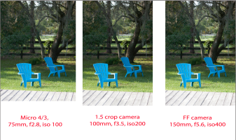

The ONLY difference is dof, and that his because in that example I was trying to illustrate the dof too. If you use a crop factor on the dof the images are identical.
Like this, 75mm or 150mm? It is the same thing from the same place. if you used a 75mm lens @ f2.8 from the same place and cropped it to the same framing it would be identical.
Reactions: 6 users

I was calling out what you said only because you put it right next to mentioning the changes you'd see via parallax when moving the camera position (true change in the images). Bouncing around in crops will be the same as throwing on a longer lens minus the difference in resolution and DOF (although DOF can be made equivalent as was demonstrated further back).
Anyway, sorry to have derailed this thread. It's just a myth that keeps getting perpetuated. I believed it for a long time and argued against it, but I finally understood once I tried some tests myself using my Leica Q's crop mode versus another full frame with interchangeable lenses. Zero difference between Q's 50mm crop (f/1.7) and another camera with 50mm @ f/1.8 shot from the same position. Only differences were those introduced by resolution, bokeh due to the lens designs, etc. But the framing and "compression" of the scene were identical. This is most often misunderstood on medium format forums where everyone thinks their sensor is super magic sauce – when in fact what they're seeing are things like superior sharpness, microcontrast, nice focus falloff, etc. due to superior medium format lenses. But the "compression" isn't better or any different.
