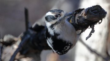

I did go to the page. The very front of the wing and face are in sharp focus, but nothing else. If it was correctly focussed, then there should have been sufficient depth of field for further back to have been in focus as well.
