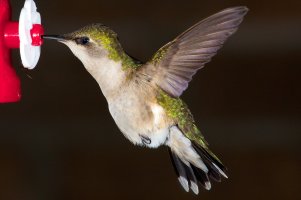

It's really difficult...plug all the holes in the feeder but one, wait a day for the birds to accustom themselves to one hole> using a tripod with a long lens and a remote shutter, pre-focus near the feeder hole. Now the tough part>grab a cuppa and wait, with the remote in your hand...when a bird comes close to your pre-focus area, fire off a burst. You won't have a high keeper rate but, you will have some killer images...like this

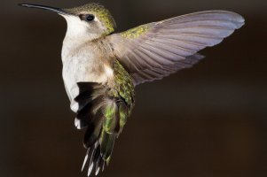

A common setup is 3-4 external flashes with radio triggers. The camera shutter isn't fast enough to freeze wing motion. With Speedlites, flash duration is inversely proportional to power - at high power, a flash is no faster than the shutter, but at minimum power (1/128), the flash duration is shorter than 1/30000 s - and that's fast enough to freeze wing motion. The reason for using multiple flashes is to get enough light at the minimum power settings.
No need to spend in exorbitant amount for the set up, you only need manual flashes and dumb radio triggers. A set of four flashes and triggers can run $200 or less.
