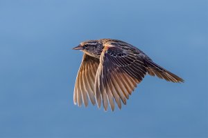

So for the R5 users out there, I'm wondering if you ever experience issues with your photos and lines running across horizontally? I've been having this problem since I got the camera and noticed it with the RF 24-105 f/4 L and it's also appearing with the RF 100-500 L lens. So this leads me to believe it's a camera issue and not a lens issue. Below are both the processed image as well as a crop at 100% of the horizontal lines I'm referring to. Is this normal? If so is there a way to not have this happen? I've already had to send my R5 into Canon for an issue with it locking up just using the animal eye auto focus to track birds. they replaced the 'circuit board'. But that was all the details they gave me. Screen Shot 2021-06-28 at 5.35.39 PM.pngTriColored Blackbird (16x9) - K1A6908.jpg

So for the R5 users out there, I'm wondering if you ever experience issues with your photos and lines running across horizontally? I've been having this problem since I got the camera and noticed it with the RF 24-105 f/4 L and it's also appearing with the RF 100-500 L lens. So this leads me to believe it's a camera issue and not a lens issue. Below are both the processed image as well as a crop at 100% of the horizontal lines I'm referring to. Is this normal? If so is there a way to not have this happen? I've already had to send my R5 into Canon for an issue with it locking up just using the animal eye auto focus to track birds. they replaced the 'circuit board'. But that was all the details they gave me. View attachment 198674View attachment 198675
Are you using full electronic shutter? What shutter speeds are you using? I've never seen anything that bad.

Yes, I was using electronic shutter to give me the 20 fps. I've been trying to make sure it's just not me being a bad photographer but the more I use it the more I'm wondering if my R5 is a clunker! I get some good shots but I think I'm at about a 10% keeper ratio. Is there anything else in the R5 that impacts the auto focus system besides the 'circuit board'?

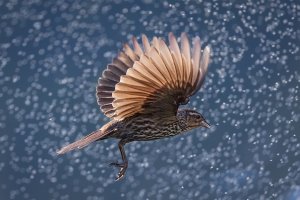

Here is another example. Just wondering if anyone else experiences this with their R5. I know this isn't a BIF thread but know many of you guys post in the BIF thread and also know this thread gets a lot more eye balls.
I've noticed it a few times but only on one shot I was really interested in using. Fortunately for me there was another frame in the batch which had an almost identical wing position and comp but still I know it is a possibility. The interesting thing is how it doesn't affect the entire image but only few feathers which makes me wonder if its related to shutter speed and the electronic shutter speed. The notable one was 1/2500 if I remember correctly.

Here is another example. Just wondering if anyone else experiences this with their R5. I know this isn't a BIF thread but know many of you guys post in the BIF thread and also know this thread gets a lot more eye balls.View attachment 198676View attachment 198677
They look like a moire style false pattern issue due to specific interactions of shutter speed/readout speed and subject motion that are being exaggerated by sharpening to me. What do they look like with all sharpening turned off?
You can notice it in the raw file before post production but obviously sharpening is going to amplify this. It pretty much only seems to happen with BIF type photos so I'm sure it has to do with the sensor readout. I'm usually shooting 1/3200th or faster with BIF photos in electronic shutter. Honestly just trying to find out if others are running into this problem or if it's just my camera. Since I've already had technical issues with the R5 I'm not feeling as confident with the quality of my particular camera. I hope I'm wrong.

Well I’d do some specific repeatable tests. Something like stick a birds feather onto a fan, turntable, etc that rotates at a known speed, then go through your shutter speeds. If it is only 3,200th and up I’d test in electronic and mechanical and if you aren’t happy with the results, tell Canon, or better yet beg borrow or steal another R5 and see if the results are the same.
In the meantime I’d remove the sharpening from the worst affected areas and try hard not to let it get to me, nobody else will really notice it!
