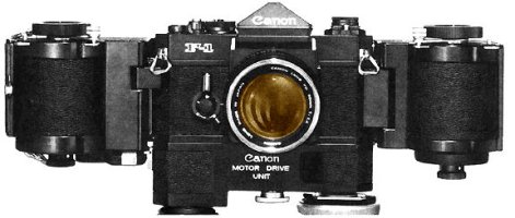

Well no Nikon was totally dominant in the pro market until Canon targeted them with their pro Eos lenses like the EF300 f/2.8 , EF50 f/1.0 and their first competitive pro camera the EOS 1n
Their older F-1 wasn't considered a pro camera by the professionals and the whole EOS system with the first decent autofocus system won the pros over to the point where nearly all pro sports photographers use Canon
I'm well aware of the history of camera gear (I'm 58) and the way Canon carefully planned their way to the top of the pro market with reliable quality gear , outstanding performance and the best customer service of any camera company
It was USM AF which was enabled by the all-electronic interface between the camera body and the lens that put Canon ahead of Nikon. Specifically, it was the original EF 300mm f/2.8L USM introduced in November 1987.
In 1987 when Canon introduced the EOS system, over 75% of professionals shooting in the 135 format used Nikon. Having said that, there were plenty of pros in the remaining 25% who shot Canon F-1s. There were certainly pro-grade accessories available for the F-1, such as high speed motor drives , as compared to consumer level lower speed power winders, and high capacity film magazines that could hold as much as 35 feet (250 frames) of bulk film.
A scant five years later, in 1992, Canon had overtaken Nikon as the #1 camera used by working pros who shot 135 - there were still a ton of pros using 645 or larger format film.
