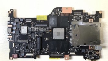

This might explain why R5 overheats. Or does it?
Take a look at the R5 internals, you will notice that the processor is sandwiched between pcbs and there's literally no effective heat conduct between heat source(cmos, processor, etc) and the magnesium body, apart from air.
This thermo image of the R5 while recording also suggest that the heat is not transferred very well to the body, which make the r5 more like a thermos mug. This is however, from my understanding, is purely done by purpose.
However
Considering The R5 can do 'almost' unlimited continues burst of 45mp in 20fps (which is very close to 8k 24fps) without any overheating even in hot weather, there is no cool down time requirement between bursts as long as the camera can clear the buffer fast enough.
Does it seems strange that even powering on and toggling the menus will greatly reduce the recording time in certain modes?
This leads me thinking, either the camera indeed cant handle that extra 4fps and all the related processing, and canon deliberately design the thermo performance this way to protect their cinema line. Or, R5 is actually capable of far better recording performance, but canon set a firmware limitation, again, to protect the C-line. Just look at the upcoming RF compact C-camera, smaller than 1dx, and 4k 120, no limits.
It seems that canon is far more than capable of producing the 'perfect' camera for both still and motion lovers. The only reason it does not do so is that it challenging its own business model. not sony or anyone else.
However
BTW, bought both R5 and A7S3. Sigh...
that layout tho, put the big hot CFExpress just beside the CPU is absolutely nightmare in my opinion. the heat are magnified by each other just by being used right?
Thats why some youtuber found that recording time extend by multiple time just by record externally without CFExpress inserted into camera body.
i think the board layout also affecting landscape photographer who wants to do long exposure photo. producing much more hot pixel in their image / dark frame.
overall im agree with what Kurt said. pretty sure canon is more than capable to deliver usable 8K DSLM . they can design the camera to well dissipate the heat . but as we know about canon, they wont sacrifice their other product line up.
However
This theory is not very well supported if you consider that R5 is capable of hours of recording to an external recorder with memory cards removed. It is either the card that is being a massive heat source or software is glitchy.
So:
  • Writing to CF express generates a ton of heat? Don't the card manufacturers have to certify their speeds can be safely obtained without overheating, data errors, etc.? Are they only on the hook for demonstrating peak speed and not some ability to run consistently under certain operating limits? Has anyone put an IR gun or contact thermometer on their cards vs. other parts of the body to see that the cards are actually heating up to a greater degree than the body in general?
  • Canon somehow implemented CF express on the R5 incorrectly? (What if the R6 also allows this no card + external recording to go longer?)
  • Canon wanted strict temp controls managed with time limits, but somehow forgot to enforce limits in the firmware for this specific no card + external recorder? (Doubt this: that would imply the dude who discovered this would brick his rig if he kept going.)
This is a weird one. Very curious to hear Canon's response to this.

So:
- A
1 . yes CF Express generates a ton of heat.
typical M.2 NVMe SSD using x3 PCI-E lane and CFExpress type B using 2X PCI-E lane if i remember correctly. although it only needs around 5-15 Watt for M.2 SSD, it does produce massive amount of heat.
thats why some fast & expensive VNMe SSD had heatsink on top of it. also consider how small the form factor of CFExpress type B is compared to M.2 SSD.
also user in another thread in this forum pointed out how NVMe may work on the camera, which is pretty similar with what we can found in our PC.
2. Most Likely
with how they place CPU & CFExpress slot, it probably is. but deliberately or not we didnt know for sure.
3. yeah same as i thought
Reactions: ahsanford
