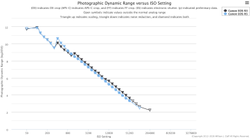

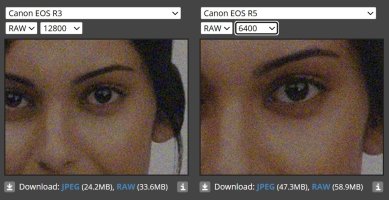

Dynamic range is primarily determined by the noise floor. If what you say is true, then an APS-C crop from the R5 sensor would have the same noise floor, and thus the same dynamic range, as the full frame image. It doesn't.

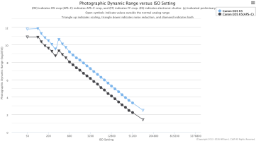

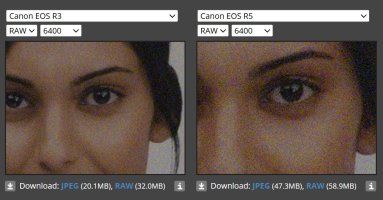

Likewise, if smaller pixels mean more noise as you suggest above, then larger pixels will have less noise, and an image from a similar-generation camera with smaller pixels and the same size sensor will have more noise and thus less dynamic range. It doesn't.
Same size pixels, smaller sensor area = more noise and less DR. Smaller pixels, same sensor area = same noise and same DR.
Not at all what I said, I said the crop has the same noise as an APS-C camera.
