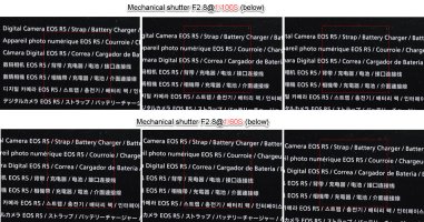

Read the 1/100s mechanical shutter shock issue before and after purchase of R5. I did not take it seriously, as a DSLR user, i thought any shock is peanut compared with mirror flip.
But, suprisely, I'm not so impressive the image from R5. I felt my R5 is not always as sharp as my 5D (I,II,III,IV, i did not miss any one), most case, it's worse.
I started to suspect the shutter shock and decided do a test myown.
Camera settings, IBIS: On, Anti-flickr: OFF, Image format: RAW, AF Mode: Single, AF Method: Spot (centre)
Lens: EF 24-70/2.8L II + Ring
Aperture: f/2.8
Focal Length: 70mm
Shooting distance: 1.5m
Camera holding: hand hold
Explanation: mechanical shutter and Elec. 1st Curtain, take 3 photos at each of 1/60s, 1/100s, 1/200s, 1/400s, 1/500s shutter speed
1st, 1/100s, this is the major complaint.
Unlucky, my one is very serious, clearly blur with MS.

I´m not sure I am going to be unfair on my comment but....You do know the rule to double the focal distance in shutterspeed right?
With all due respect this is a shutter-shock problem, and not related to focal distance or other variables you mention. It is not affected by IBIS being on or off.
You should try, as I did with an Rf 24-70mm to take shots from 1/60th-1/200th in both mechanical and EFCS shutter-modes. Let us know if you see the softening of images in one versus the other.

So I went to the other thread and downloaded the full sized attachments that I do not believe are forum resampled, I believe only in line images are resampled.
Anyway, are we really saying at 100% crops from a 45mp camera this difference is an "issue"? To me the biggest differences are the contrast, WB, and exposure. The lighting was very different in the two shots as one had a person blocking a part of the window and that reduced glare and improved contrast a lot. The biggest 'issue' I see in comparing the two images is the subsequent difference in contrast, the WB change, the specular highlights and overall image brightness.

Ok, fair enough. I'm going to use a real test-pattern target with controlled lighting. Canon won't likely be persuaded by vitamin bottles and train schedules.
And then I'm going to post them in a new thread, not buried in this one. later in this thread Anybody can comment and/or add new ones.

So here is the thread at DPReview where they used a test target, equal lighting etc.
I took the 'worst' example, 1/100 sec mechanical shutter, and did an accurate comparison with the ES version.
Can anybody seriously tell me 100% crops from a 45mp camera the differences illustrated amount to an issue?
